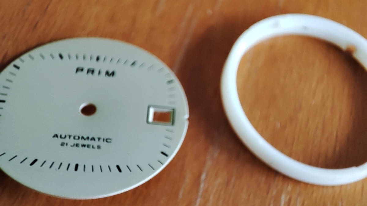

MatoMato Posted September 21, 2022 Report Posted September 21, 2022 Utuzenie minutovej trubky u kalibru 96 automat je lahsie ako u kalibru 66, popripade 68. Netreba tolko rozoberat... Prikladam fotky z utuzenia Prim televize kaliber 96 automatic. Niekomu mozu pomoct. Images are visible only to registered users. Please register or sign in to enable full experience. Images are visible only to registered users. Please register or sign in to enable full experience. Images are visible only to registered users. Please register or sign in to enable full experience. Images are visible only to registered users. Please register or sign in to enable full experience. Images are visible only to registered users. Please register or sign in to enable full experience. Images are visible only to registered users. Please register or sign in to enable full experience. Images are visible only to registered users. Please register or sign in to enable full experience. Images are visible only to registered users. Please register or sign in to enable full experience.
