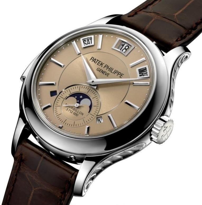

Patek Philippe - 5207P - Perpetual Calendar - Minute Repeater -
Odesláno (upraveno)
Technical data
Grand Complication Ref. 5207 in platinum with minute repeater, instantaneous
perpetual calendar in apertures, tourbillon, and moon-phase display

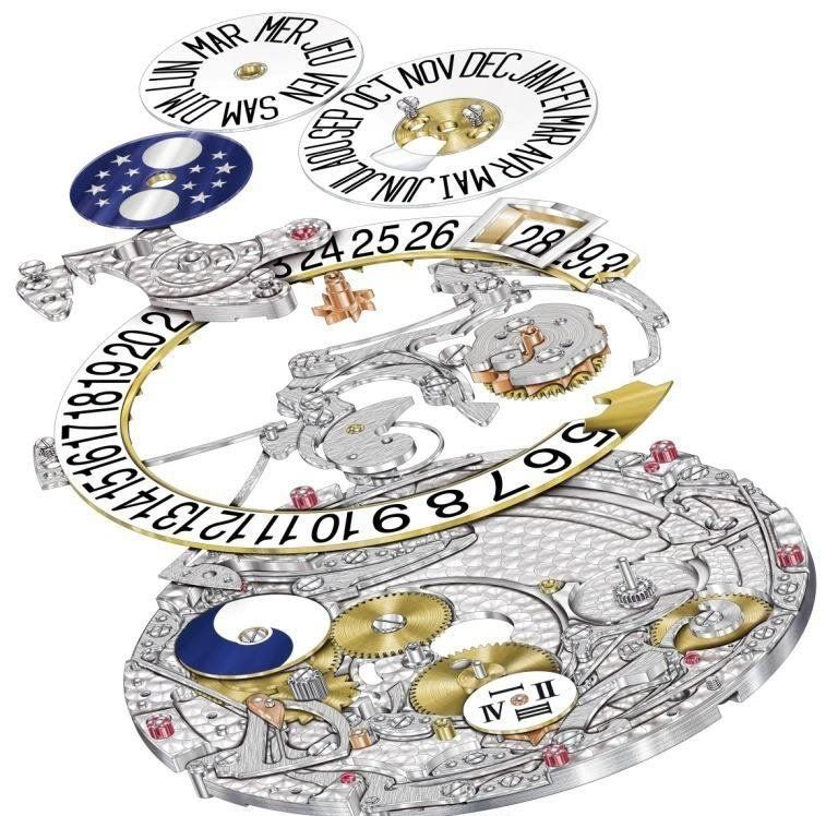

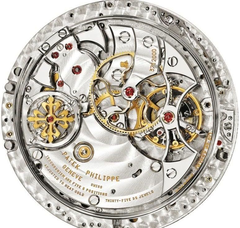

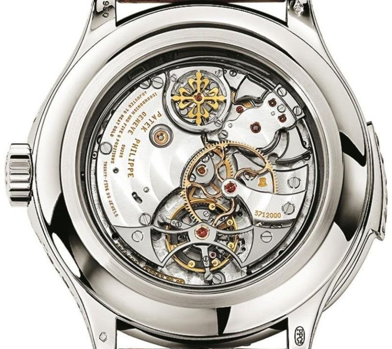

MOVEMENT
Caliber: R TO 27 PS QI: Manually wound mechanical movement, tourbillon, minute repeater,
instantaneous perpetual calendar. Apertures for day of week, date, month, leap-year cycle,
day/night indicator, moonphase display, and seconds subdial.
Overall diameter: 32 mm.
Height: 9.33 mm
Number of parts: 548
Number of jewels: 35
Power reserve: max. 48 hours
Balance: Gyromax
Frequency: 21,600 semi-oscillations/hour (3 Hz)
Tourbillon: Tourbillon cage in steel, 69 parts, 0.3 grams 1 rpm. Tourbillon on one axis with balance and fourth wheel
Balance spring: Breguet
Balance spring stud: Movable
Functions:
Two-position crown:
- Pulled out: to set the time
- Pushed in: to wind the watch
Certification: Exclusive certificate issued jointly by the C.O.S.C (Contrôle Officiel Suisse des Chronomètres)
and the Geneva Seal
Hallmark: Geneva Seal

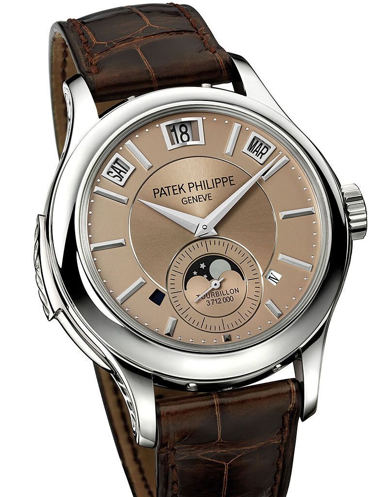

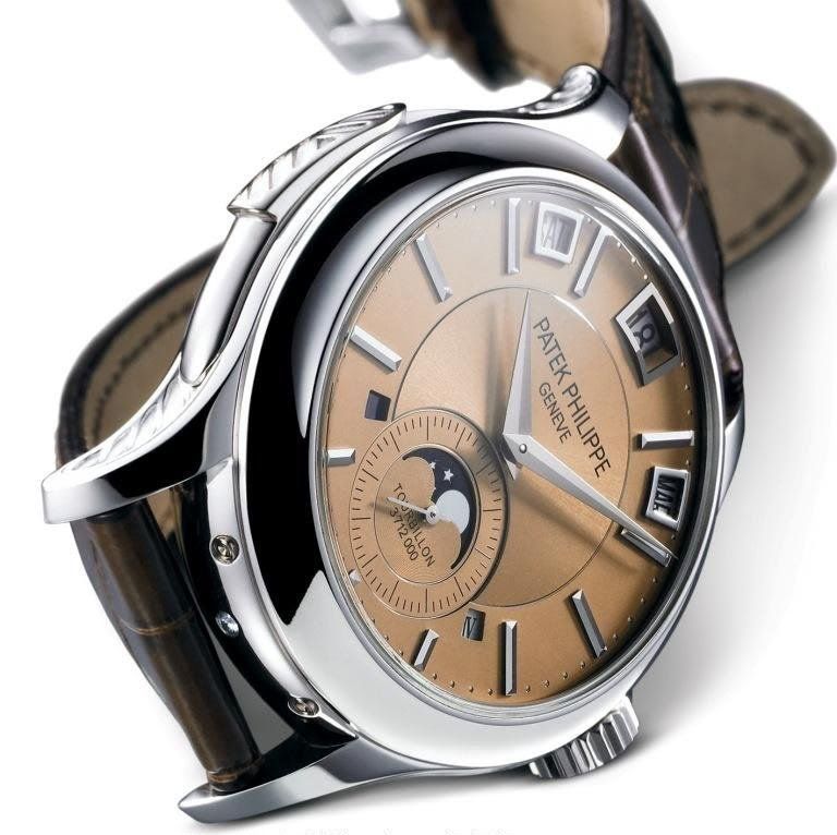

Displays:
With hands:
- Center hours and minutes
- Seconds at 6 o'clock
In apertures:
- Day of week between 10 and 11 o'clock in polished white-gold frame
- Date at 12 o'clock in a polished white-gold frame
- Month between 1 and 2 o'clock in a polished white-gold frame
- Moon phase at 6 o'clock
- Day/night indicator between 7 and 8 o?clock
- Leap year cycle between 4 and 5 o?clock
Corrector push pieces:
- Day between 11 and 12 o'clock
- Date between 6 and 7 o'clock
- Month between 12 and 1 o'clock
- Moon phase between 5 and 6 o'clock
Setting stylus in ebony and white gold included
Minute repeater with small strike (hours) on the 1st gong, minutes on the 2nd gong, and quarter hours on both gongs.
FEATURES

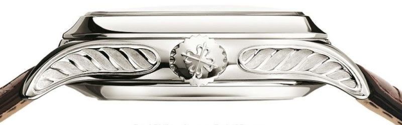

Case: 950 platinum, delivered with solid-platinum back and interchangeable sapphire-crystal back;
diamond with approx. 0.02 ct. between the lugs at 6 o'clock
Dimensions:
Diameter: 41 mm
Height: 16.25 mm
Width between lugs: 20 mm
Slide:
In the side of the case to start the minute repeater
Dial:
18K gold, Honey Gold hue (New exclusive Patek Philippe dial color)
11 hour markers in 18K white gold
Dauphine hands in 18K white gold for hours and minutes
Baton seconds hand with counterweight, 18K white gold
Minute scale on periphery of dial
Strap:
Shiny brown alligator with rectangular scales, hand-stitched, 16-mm prong buckle in platinum.
Price:
approx. $675,000
