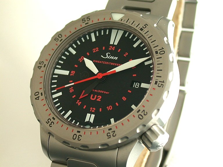

PhoeniX Odesláno 29. ledna 2008 Nahlásit Odesláno 29. ledna 2008 The U1 is designed to be virtually impervious to water penetration. The U1 case is made from the same steel that is also used in the construction of the outer hull of submarines. The steel was procured by Sinn from a steel supplier to Emden GmbH, one of Germany?s North Sea shipbuilding yards who construct submarines from the very same steel. This submarine steel is not only extraordinarily sea water resistant (PRE value up to 38), it possesses also the highest anti-magnetic quality. Tak si říkám, jestli by se na fóru nenašel někdo, kdo ví o zmíněné oceli něco bližšího. Je to opravdu takový zázrak nebo se jedná o marketing. Jen podotýkám, že zde zobrazené hodinky mají průměr pouzdra 44 MM a jsou vodotěsné do 1000 a 2000 metrů.

Bobr Odesláno 30. ledna 2008 Nahlásit Odesláno 30. ledna 2008 Doplňuji, zdrojem jsou informace z www.chronomaster.co.uk , který je dealerem Sinnu pro GB: The steel was by procured by Sinn from a steel supplier to Emden GmbH, one of Germany?s North Sea shipbuilding yards who construct submarines from the very same steel. This submarine steel is not only extraordinarily sea water resistant (PRE value up to 38), it possesses also the highest anti magnetic quality. Another main advantage of this steel that Sinn?s Tegiment technology could also be applied where the submarine steel can be hardened on up to 1500 Vickers. Compared to regular 316 L stainless steel which is hardened to approximately 220 Vickers. K rozdílu mezi tvrdostmi 220 Vickers a 1500 Vickers ať se vyjádří zde přítomní metalurgové

PhoeniX Odesláno 30. ledna 2008 Autor Nahlásit Odesláno 30. ledna 2008 Doplňuji, zdrojem jsou informace z www.chronomaster.co.uk , který je dealerem Sinnu pro GB: The steel was by procured by Sinn from a steel supplier to Emden GmbH, one of Germany?s North Sea shipbuilding yards who construct submarines from the very same steel. This submarine steel is not only extraordinarily sea water resistant (PRE value up to 38), it possesses also the highest anti magnetic quality. Another main advantage of this steel that Sinn?s Tegiment technology could also be applied where the submarine steel can be hardened on up to 1500 Vickers. Compared to regular 316 L stainless steel which is hardened to approximately 220 Vickers. K rozdílu mezi tvrdostmi 220 Vickers a 1500 Vickers ať se vyjádří zde přítomní metalurgové Už jenom z laického pohledu je to velký rozdíl. Jen jestli nekecají...
ego alter Odesláno 30. ledna 2008 Nahlásit Odesláno 30. ledna 2008 byl jsem se mrknout na chronomasteru a gnomonu rozdíl vidím pouze na korunce a podkladu data tak pozor! :-) ty sinny nahodou mam a jeste jsem vypozoroval toto: o 1 mm vetsi prumer pouzdra,vzhlednejsi hodinova rucicka stopek, WR 200m, lepsi korunka....a udajne osobne poladene helmutem sinnem! :-) .....jak se to rika- ci chleba jis, toho pisen pej? :-)
