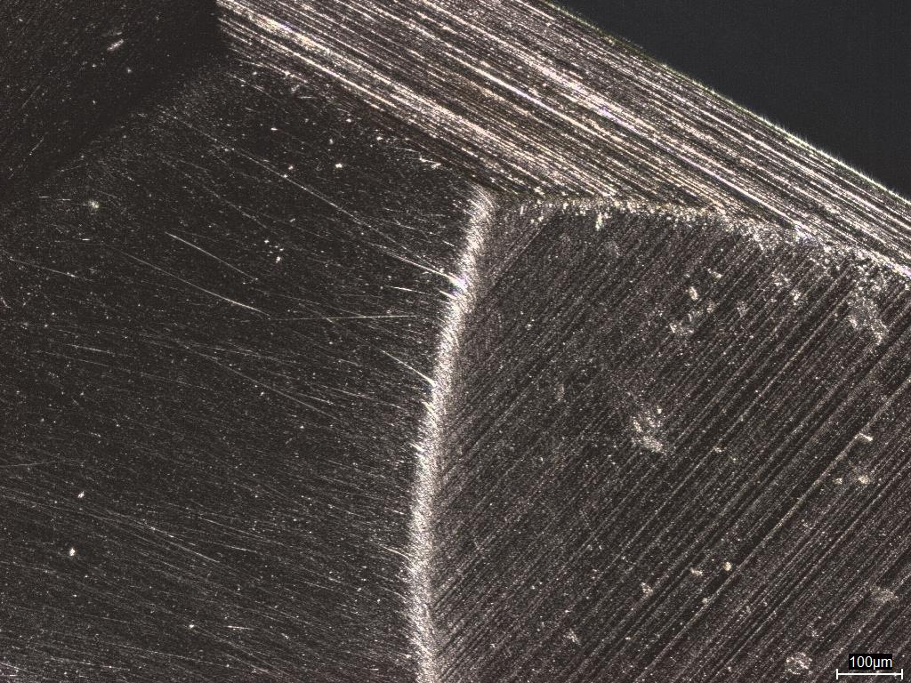

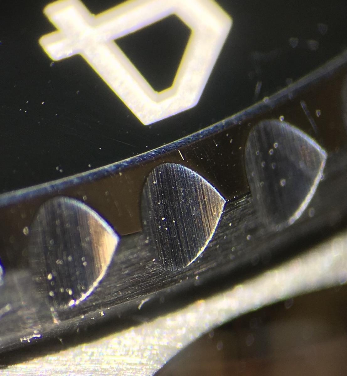

Potkan Odesláno 22. listopadu 2019 Nahlásit Odesláno 22. listopadu 2019 Kolegove, vsiml jsem si u Batmanu (ale plati i pro Suby i dalsi modely s otocnou lunetou), ze zoubky u lunety jsou krasne nalestene z horni strany a brousene ze strany spodni. A to v horizontalnim smeru. Vnitrni konkavni povrch mezi zoubky je pak brouseny ve vertikalnim smeru. Celkove to vytvari nadhernou podivanou i pouhym okem. Oficialni fotky na strankach Rolexu to zobrazuji velmi detailne. Proto jsem narychlo jeste poridil fotku laserovym mikroskopem, at mame srovnani. Sorry za ten prach, fakt to neslo lepe vycistit, zkousel jsem to i foukat pistoli se stlacenym vzduchem, ale ten mikroskop fakt vidi uplne vsechno. Levy spodni roh snimku zobrazuje vylesteny horni povrch lunety a vpravo dole je "mezizubni" prostor brouseny vertikalne. Tolik srovnani teorie a reality

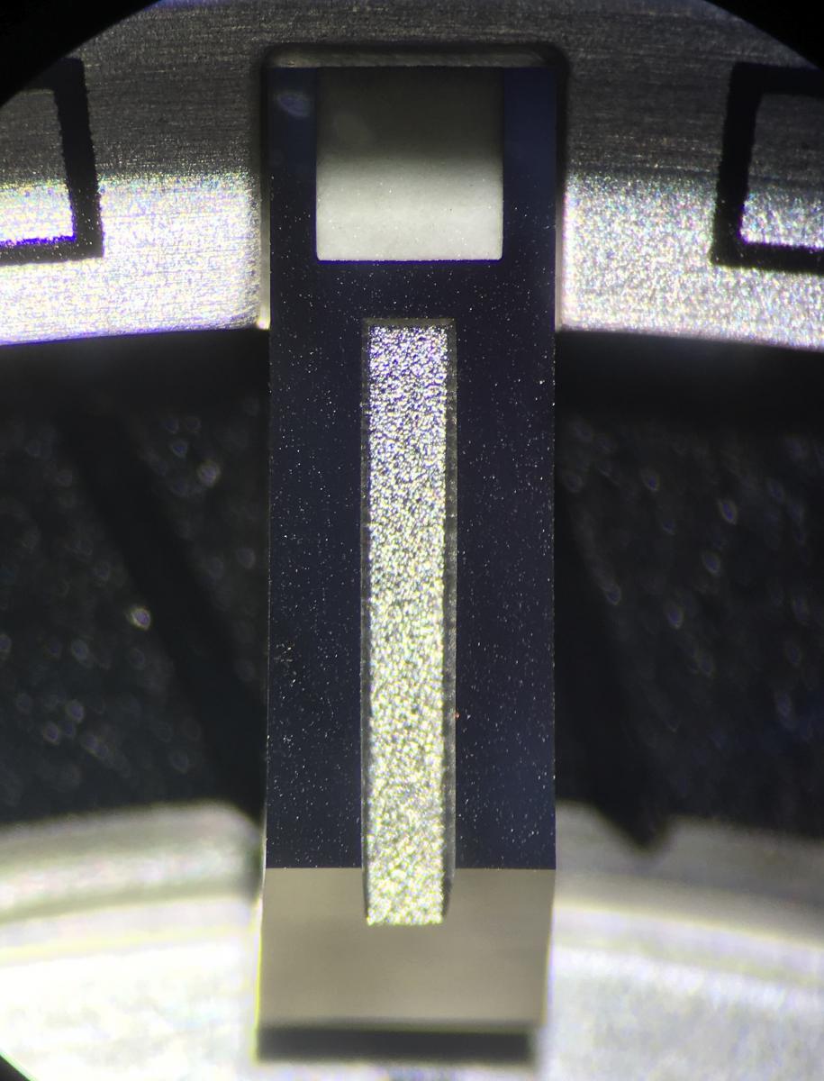

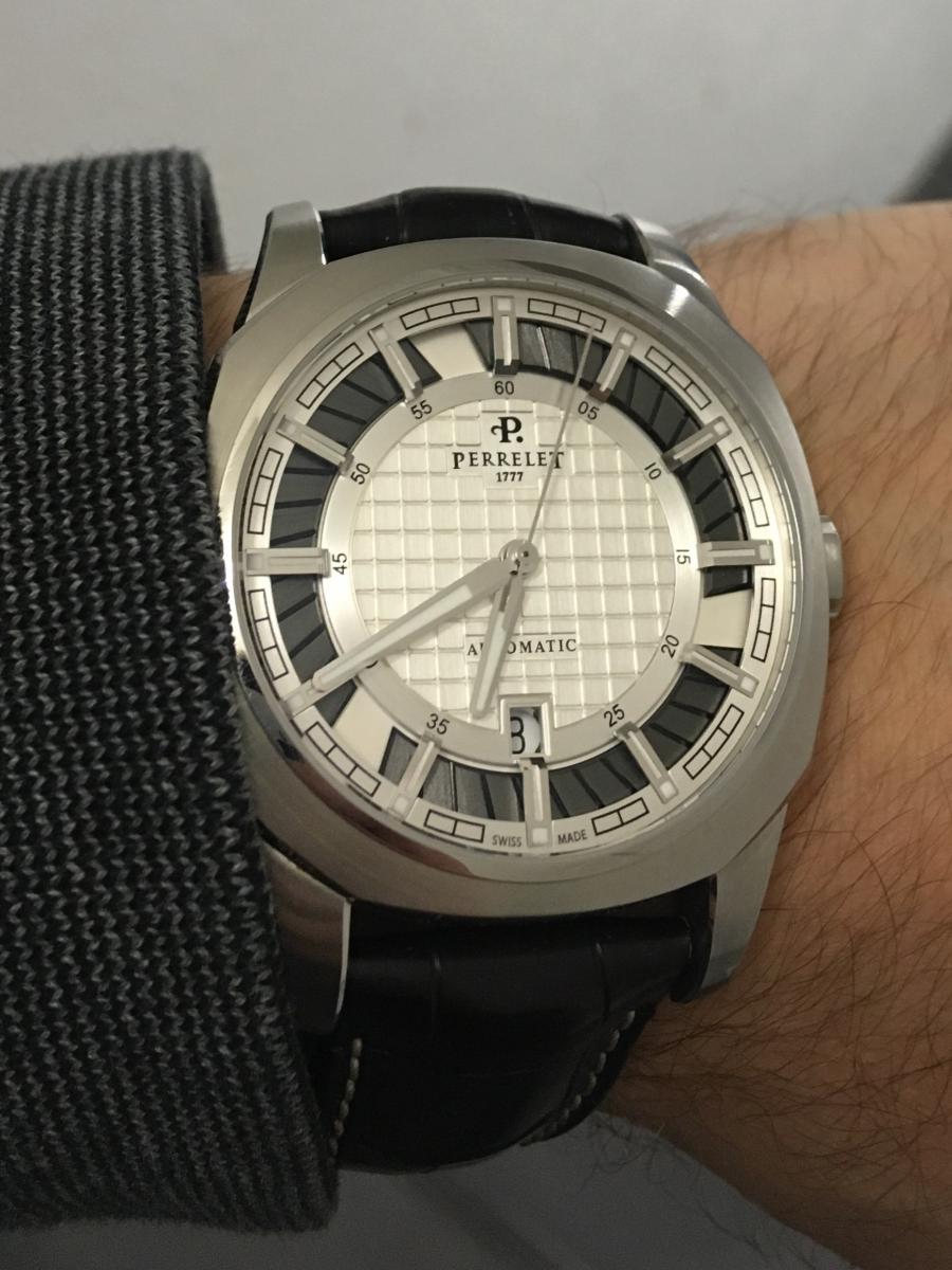

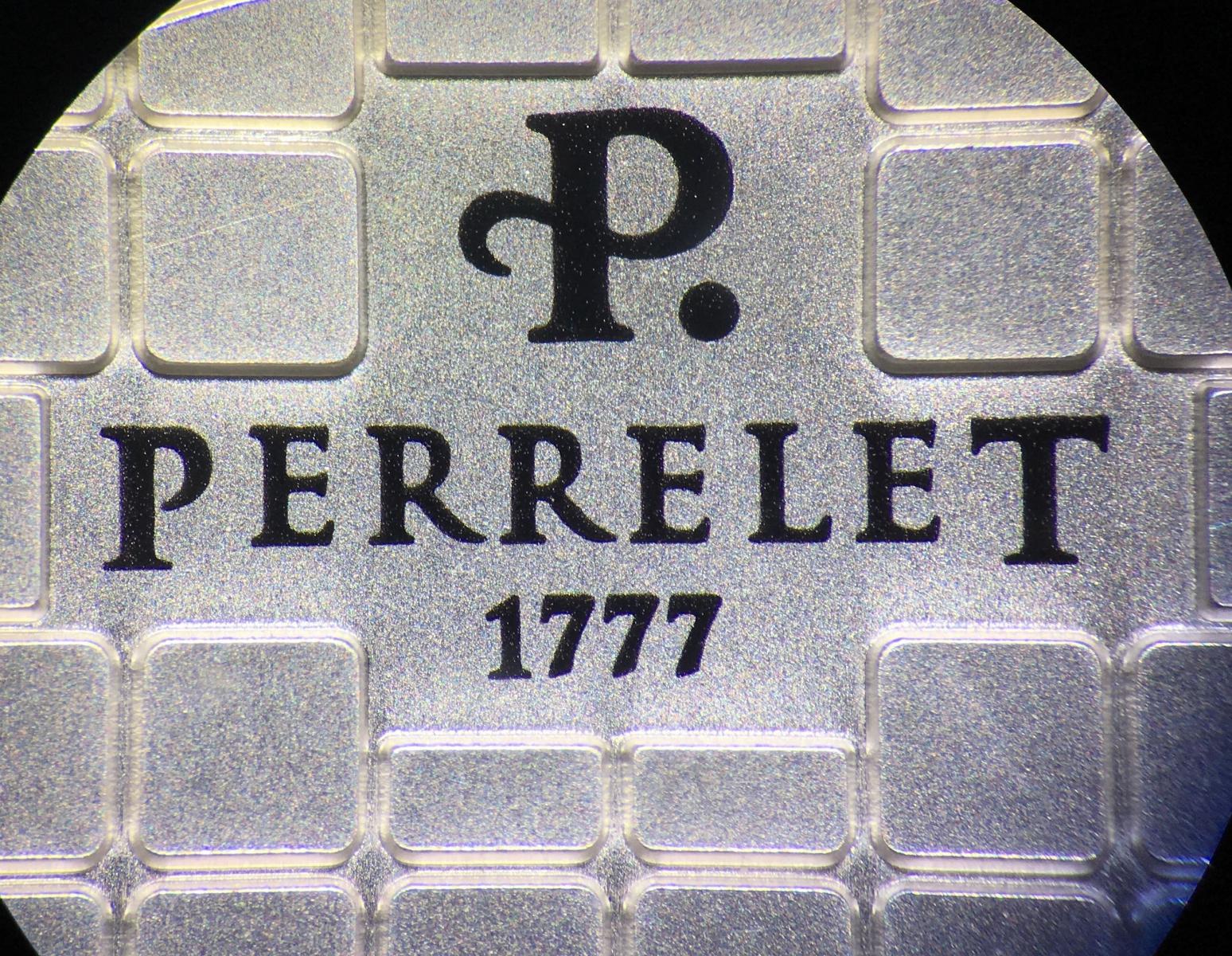

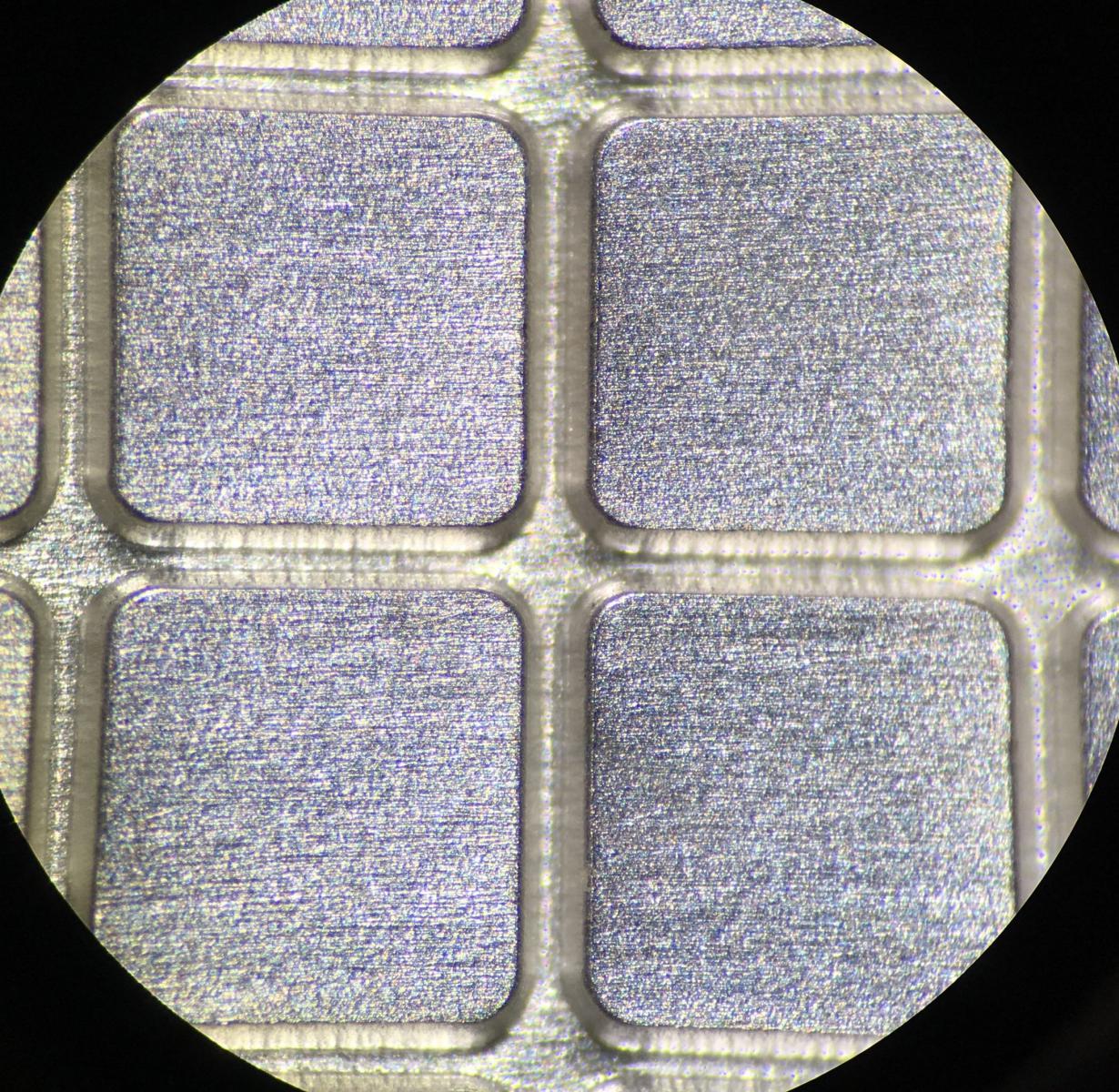

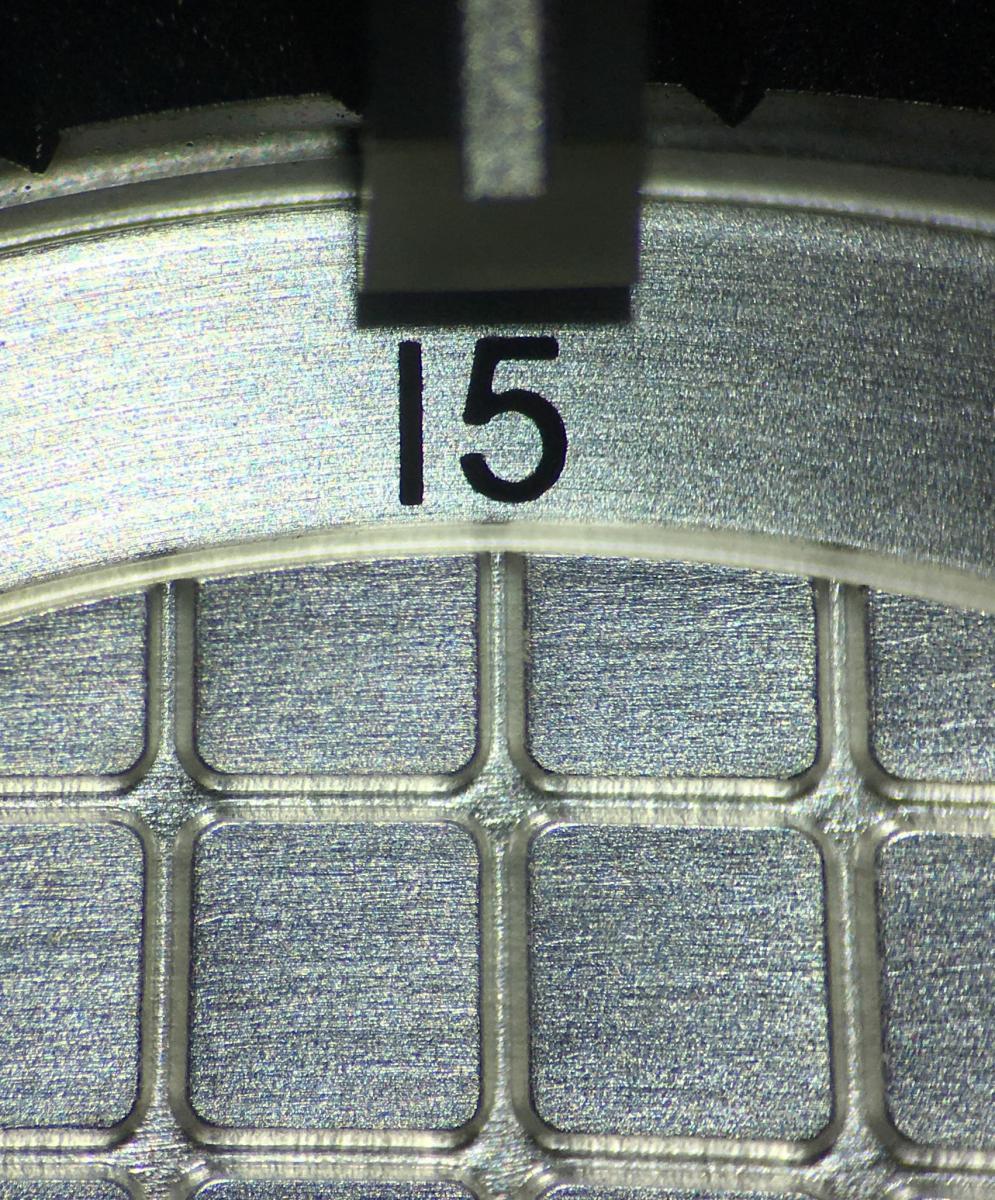

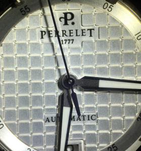

Potkan Odesláno 22. listopadu 2019 Nahlásit Odesláno 22. listopadu 2019 Next piece for an inspection would be my Perrelet Peripheral Double Rotor which I love for its attention to detail. This time I have no laser microscope pictures, all photos are taken by a mobile phone through a stereo microscope lens. Dial 3 index and its luminova 3 index with cutting sharp edges 3 index spanning over the upper rotor dial on 3 o'clock part of the upper rotor dial structure dial printing ...to be continued

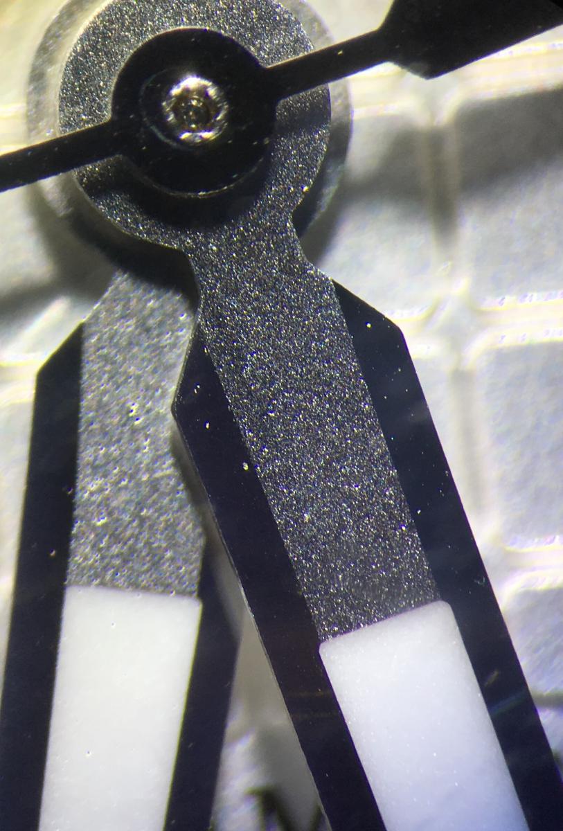

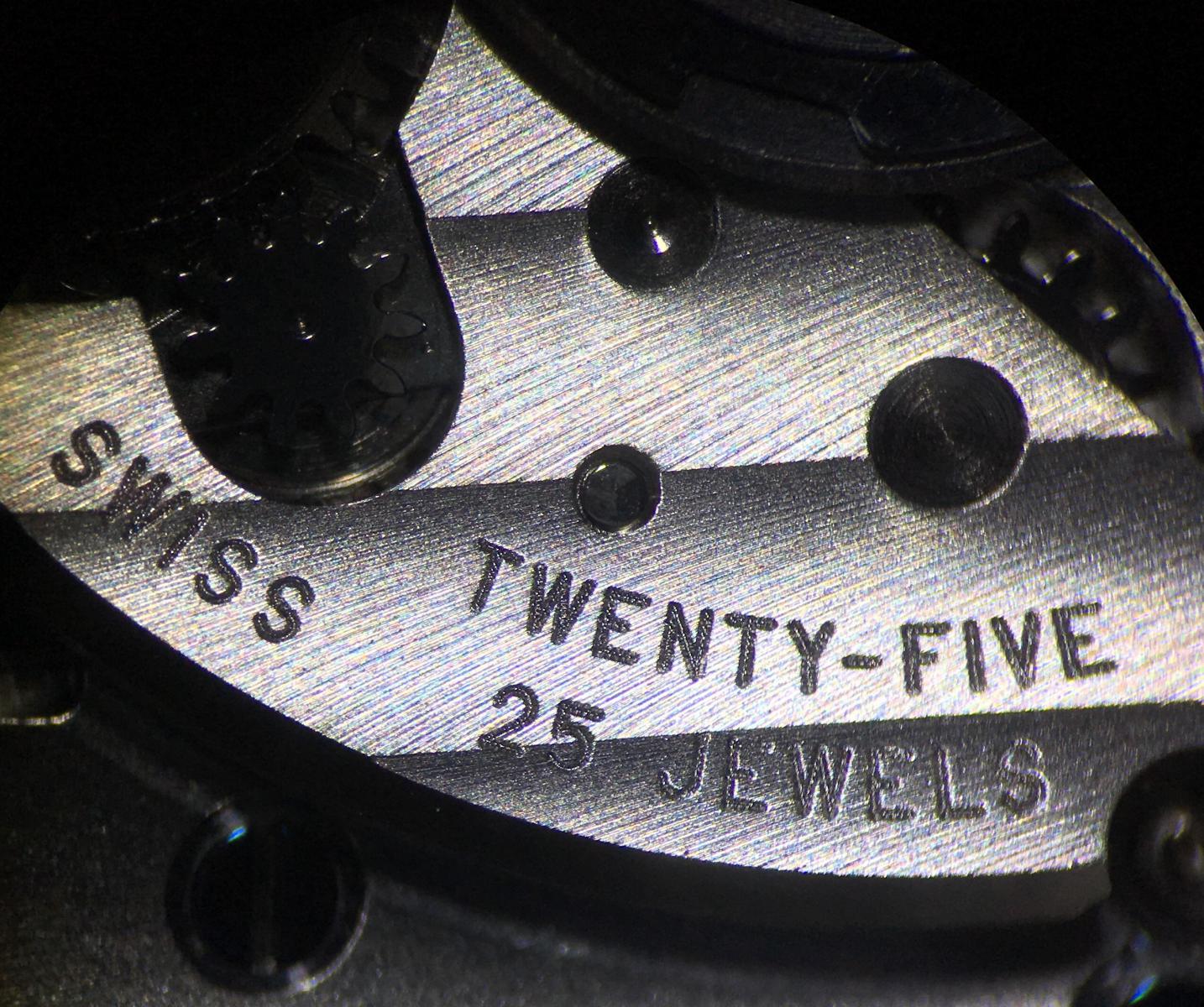

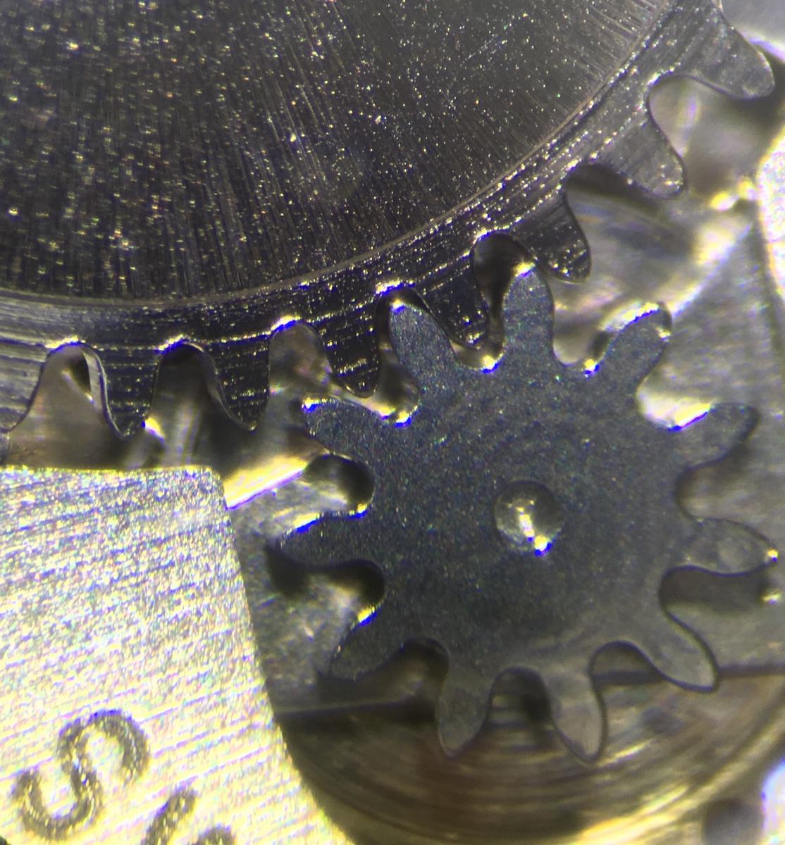

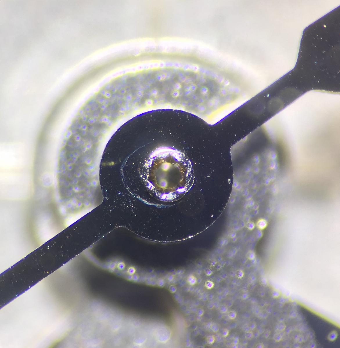

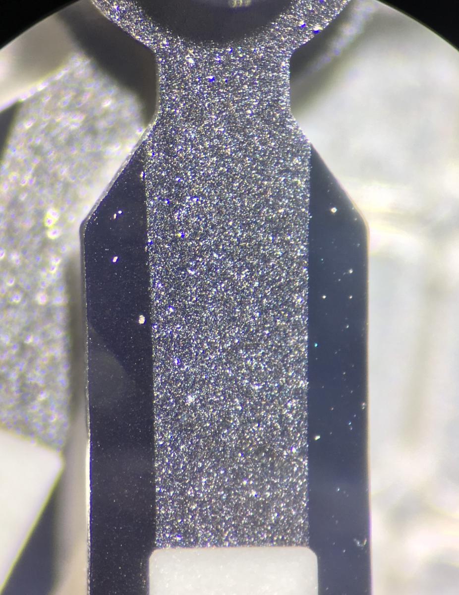

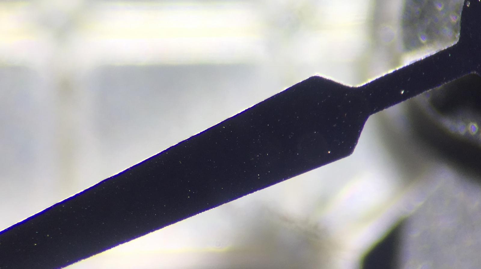

Potkan Odesláno 22. listopadu 2019 Nahlásit Odesláno 22. listopadu 2019 ...with the hands central seconds counterbalance of the seconds hand - see no scratches, only mirror finish (just to point out the comparison to a particular Swiss watch brand with a crown ;-) ) various surface finishes on the minute hand including luminova you might notice the white spots - that's some dust that remained on the dial side after opening the watch during its regular service. Not visible by naked eye. cogwheels in the movement movement plate after seeing the amount of dust particles I sent the watch back to the service for another round of cleaning...

ismit Odesláno 22. listopadu 2019 Nahlásit Odesláno 22. listopadu 2019 V 22. 11. 2019 v 18:19, Potkan napsal: Kolegove, vsiml jsem si u Batmanu (ale plati i pro Suby i dalsi modely s otocnou lunetou), ze zoubky u lunety jsou krasne nalestene z horni strany a brousene ze strany spodni. A to v horizontalnim smeru. Vnitrni konkavni povrch mezi zoubky je pak brouseny ve vertikalnim smeru. Celkove to vytvari nadhernou podivanou i pouhym okem. Oficialni fotky na strankach Rolexu to zobrazuji velmi detailne.Tohle je geniální příspěvek! dělám si vlastní soubor "perly z chronomagu", kam občas něco přidám, když mě to fakt extra zaujme. tento vědecký příspěvek tam má své čestné místo. Díky moc vám oběma za naprosto skvělou práci! @Potkan: většina textu je anglicky, dáváš to ještě na nějaké mezinárodní fórum?

Radik Odesláno 22. listopadu 2019 Nahlásit Odesláno 22. listopadu 2019 Rozhodně zajímavý fotky. Pamatuju na školní léta, kdy jsem prvně pod mikroskopem viděl klíště, nějaký vypěstovaný prvoky - tuším trepky - a jak jsem měl pak touhu vidět detaily mnoha dalších přírodnin. Tam mě to fascinovalo. Tady, kde se očekává dokonalost, mě to spíš drásá nervy. Co ten drbanec vlevo nahoře u "dial printing" toho Perreletu?

Potkan Odesláno 24. listopadu 2019 Nahlásit Odesláno 24. listopadu 2019 V 22. 11. 2019 v 20:36, Radik napsal: ...Co ten drbanec vlevo nahoře u "dial printing" toho Perreletu? Jak jsem uz psal, hodinky byly na pravidelnem servisu. Asi pozdrav od hodinare...

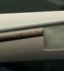

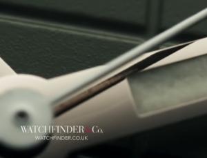

Potkan Odesláno 21. prosince 2019 Nahlásit Odesláno 21. prosince 2019 Screenshot z videa od Watchfinder - Patek Aquanaut To je nejakej joke s tou vterinovkou, ne? Hlavne, ze jsou rucicky zvrchu vylesteny jak zrcadlo...a co potom v tom zrcadle clovek spatri?
nooski Odesláno 21. prosince 2019 Nahlásit Odesláno 21. prosince 2019 Při takovém zvětšení je dokonalost prakticky nedosažitelná. Makrofotky a záběry hodinek mě opravdu baví a co jsem zatím viděl, tak opravdu hodně dobře jsou v tomto ohledu GS. Naopak Rolex je občas téměř na úrovni pětek :-)

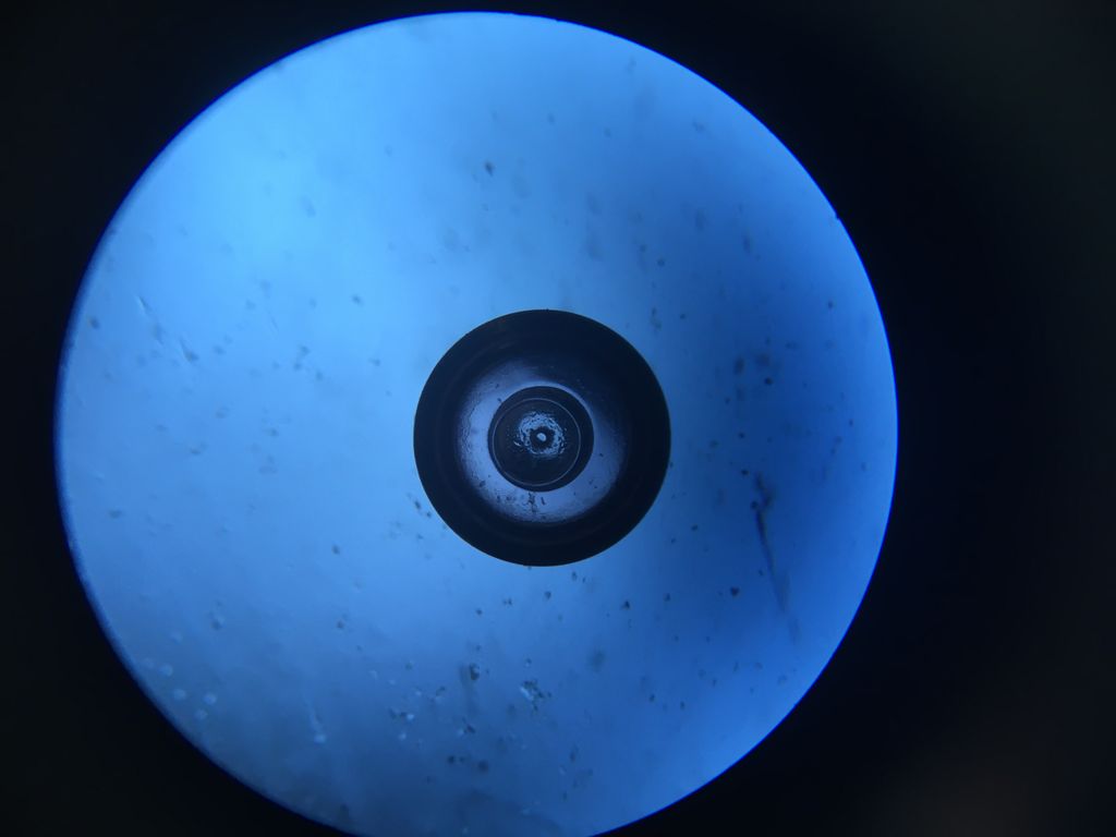

Jeronimo Odesláno 21. prosince 2019 Nahlásit Odesláno 21. prosince 2019 Kontrola čistoty a namazání kamenů setrvačky. Tak se mikroskop určitě hodí.

xbraj19 Odesláno 7. května 2021 Nahlásit Odesláno 7. května 2021 @Potkan leštěné zespodu to nebude mít skoro nikdo. Co jsem viděl fotky, tak ani top verze Credor (Eichi II) a GS je neměly zespodu vyleštěné.
